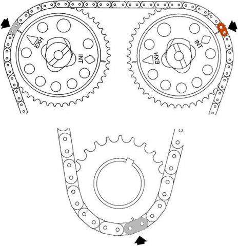

Took it all back apart to retime tomorrow. Setting crank to 5 o'clock like it says in the all data instructions intake to 5 o'clock and exhaust to 7 o'clock then put the intake gear on and hope everything goes right

Crank 5 o'clock
Intake 2 o'clock
Exhaust 10 o'clock
The intake and exhaust will line themselves up, if the crank is correctly lined up
Maybe that's the problem above in red.
As Oldblue stated, it's a 10 o'clock, 2 o'clock position for exhaust, intake marks.
Name:  timing marks.jpg

Ok will look with gears on seeing all data is the cam notches with out gears on the cam
