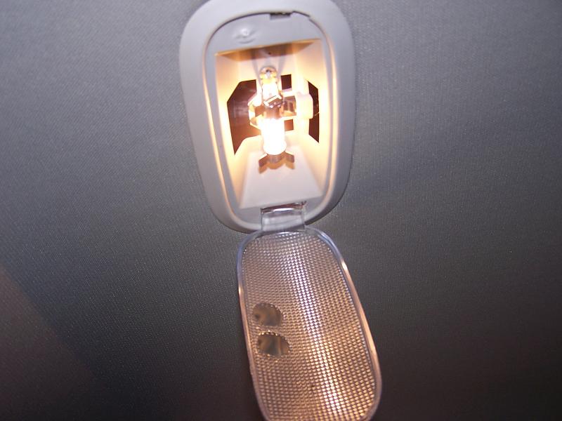

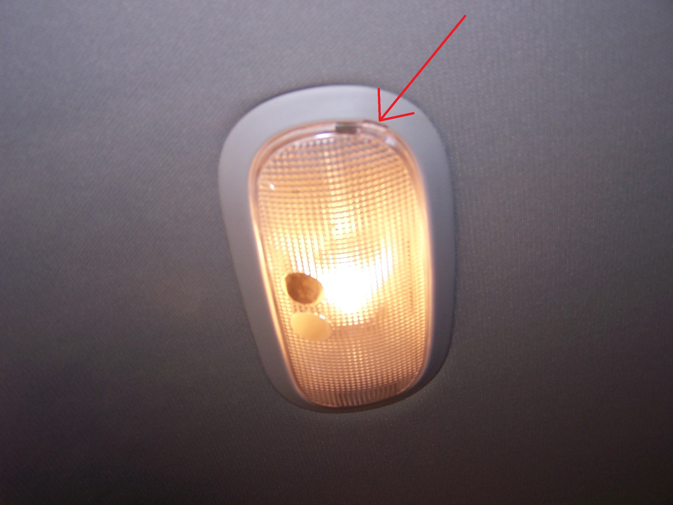

Actually, that rear cargo lens needs a flat screwdriver to open it. Insert the screwdriver in the slot(red arrow) and pop the lens loose.
It's a little tricky to put back in place and easier if you use the screwdriver again to close it.

FMG to the rescue!! that's what we needed to address this bulb access issue, thanks for the pictures, was this your SS in the pictures

Yes Oldblue.
Since the OP has a 2010 model, I figured mine would be the same.
