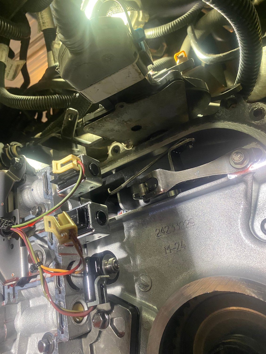

Dannyh1964's Avatar
Joined: 02-21-2023
Posts: 28
From: Monticello MN

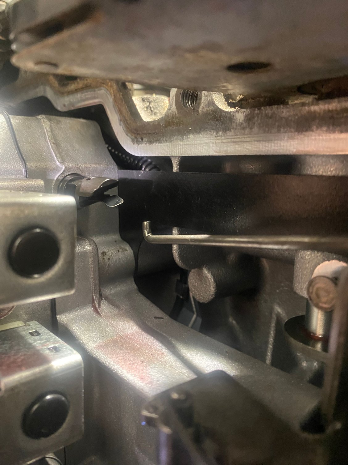

This is what I found once opened. Looking at post and old blues last recommendation, this is as what I was hoping to find. I do not know how it came off. Most likely because I did not loosen the PNP switch on the top of the transmission. The area would have been tight and could have pushed it off. Will post again once it is driving.
Second picture shows the position where the shift connector is located. Top right of transmission under the cover. Thanks everyone!!
