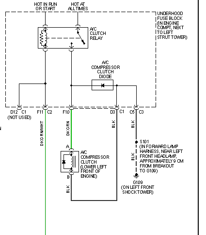

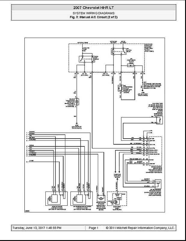

AC clutch now that I think of it has not been turning on. The reason I know: The fan must be on for the AC clutch to run if I'm not mistaken (feel free to correct me). The fan has hardly ever been turning on. The fan has only turned on when engine temperatures get high. I just tested now: AC clutch does not run.
I feel there might be a few more bubbles in there, but I need to wait for the car to cool down. Still odd if it were bubbles, since the thermostat is opening and closing on point and heating and coolant temp readings are working.

Thanks Old Blue, I will do just that. I'll report back here. I'm starting to think I might need to take it to an AC shop to get the freon/compression tested, since I believe the AC clutch won't kick on unless there is a minimum compression. I will see if instead of going to an AC shop I can buy a tool at a reasonable (sub $40) price to test.
I generally prefer to spend on tools which can be used for multiple fixes, than paying per fix.
Of course, all this after doing the top off and seeing if I can squeeze out bubbles.
