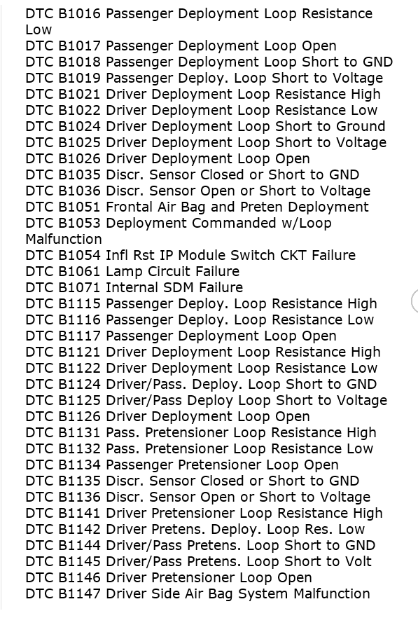

Depending on WHAT is wrong, a new seat might fix it. The sensors have been known to malfunction, especially if people sit in the seat with hard/sharp objects in their back pockets, combs, screwdrivers, snuff boxes etc.
For instance here are some of the possible codes, there are more.
