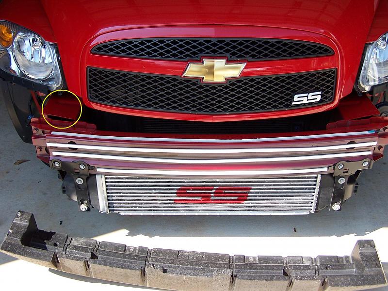

Is there a way to calibrate or do I have to replace the sensor. Can someone tell me where the sensor is for sure and is it just a plug in mounted somewhere.

I know that somewhere in the 81 results I got for "ambient air" there are pictures of the location, I only had a few minutes to look. If you got time give the search tool a shot.
