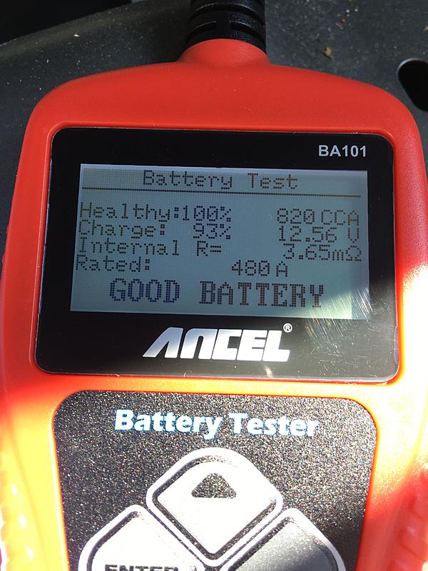

I wasn't 100% convinced that it wasn't a bad battery so I borrowed a friend's tester that we know works. When I tested it at the battery it also tested as a good battery (see attached "good battery" picture).

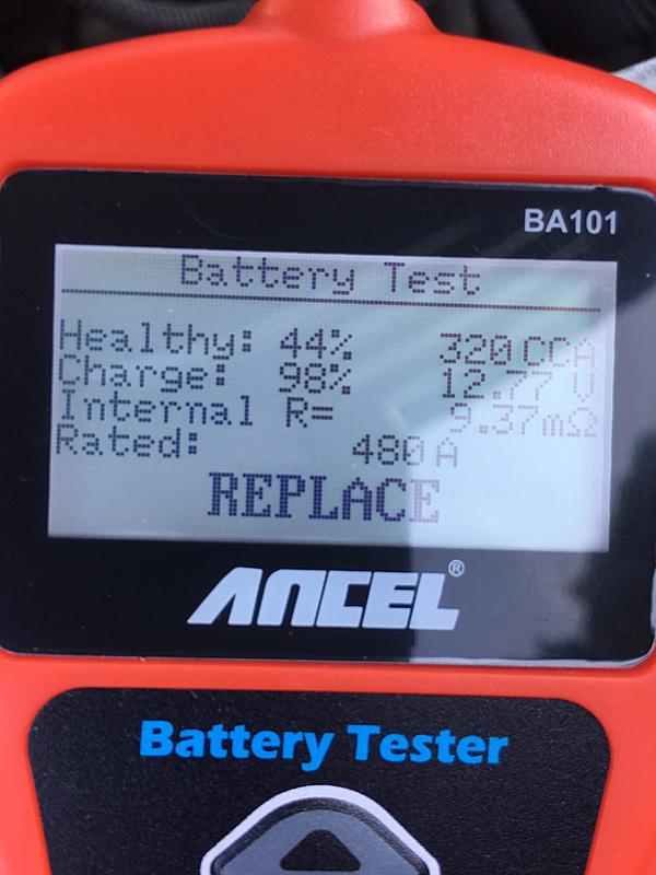

I then decided to hook the tester up under the hood at the terminals. I should also note that while attempting to charge the battery using the under the hood terminals, I have never been able to get the charger to get to the full charge state using the 10 Amp setting on the charger. Back to the tester, under the hood terminal test shows completely different results saying to replace the battery (see "replace battery" picture). Is this normal?
I had always thought that the under the hood terminals should provide similar if not exact results as directly on the battery.

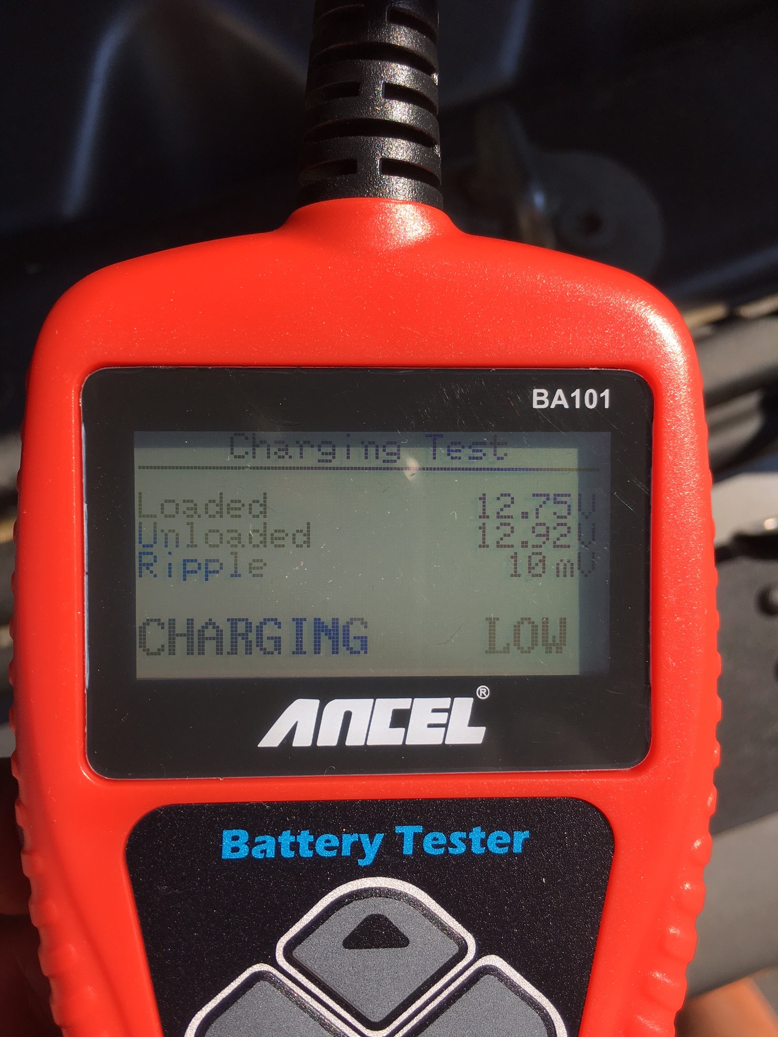

I also tested the charging system and that showed up with a charging system issue (see "charging low" picture). I know there's a good chance that the alternator or generator as GM calls it is bad and needs to be replaced. But since the battery test was done without the car running, therefor the alternator not being a factor, could I have another issue happening along with the alternator?
