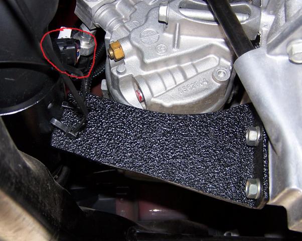

This old picture shows a switch on the compressor.
(the red circle was for another thread about Tmap wiring)
Name:  SS IC bracket.jpg

WOW! Awesome FiremanGeorge! you got a good memory to find that!!
My favorite Uncle was George and a Fireman in Phila!
Thanks!!
