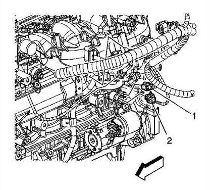

Does it run now? Just not good? Any codes? Does the wiring harness fit?
I think that the crankshaft sensor is on the back side on a 2.4 and the front on a 2.2.

there on the front , 2.4 or 2.2 and 2.o ?
Old Feb 28, 2020 | 08:10 AM
Posts: 40,082
That ‘tis , just above and behind the starter

Well, then the harnesses should be the same?
The connectors on the harness are pretty much "idiot proof". They layout pretty close to where they belong and most of the connectors are different from each other.
