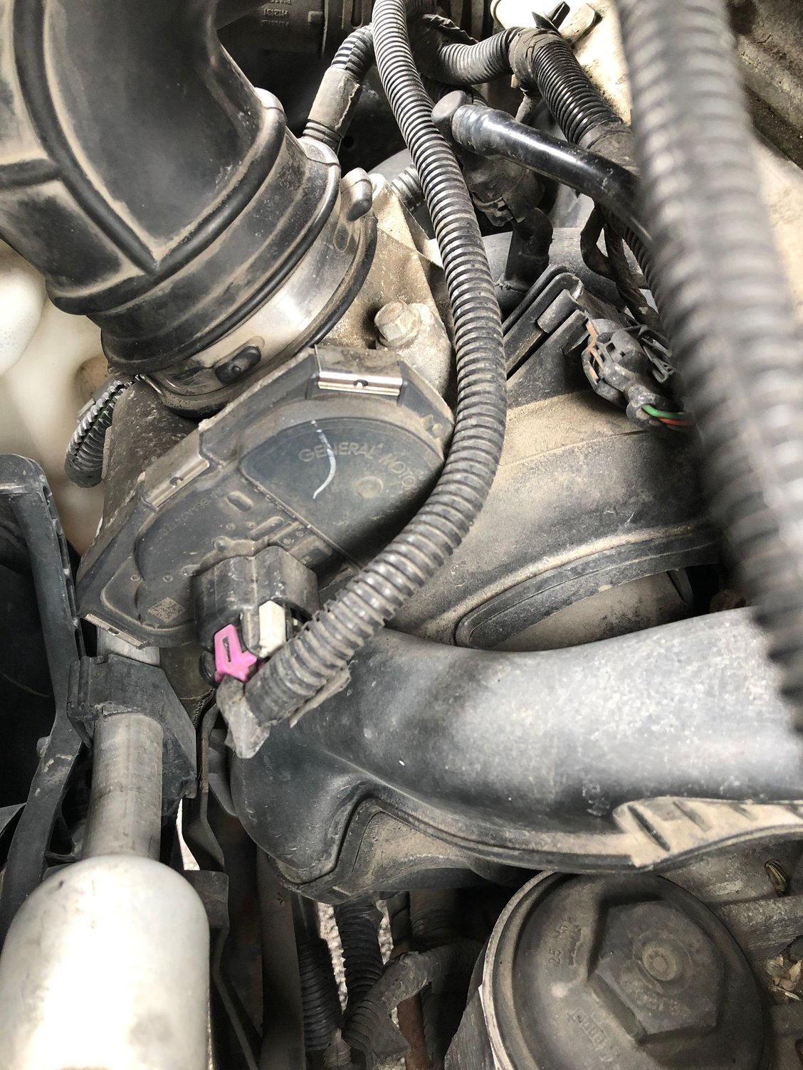

Air box was off when I took pics
The air flow sensor is hooked up to a different connector then the one coming off the fuel rail harness.

But why not connected to the correct connection?
Have you tried connecting the MAF to the proper connection?

I apparently have two connection to the air flow sensor then.... well that's confusing

How could it if it’s not connected to the correct connection in the harness.

Look next to the abs module in the picture, you'll see the sensor and second connection

Donbrew, that red connector you've circled, are you sure that's for the MAF?
I seem to remember someone saying that they accidentally switched the connectors for the throttle body and something else, they both had the same connector.

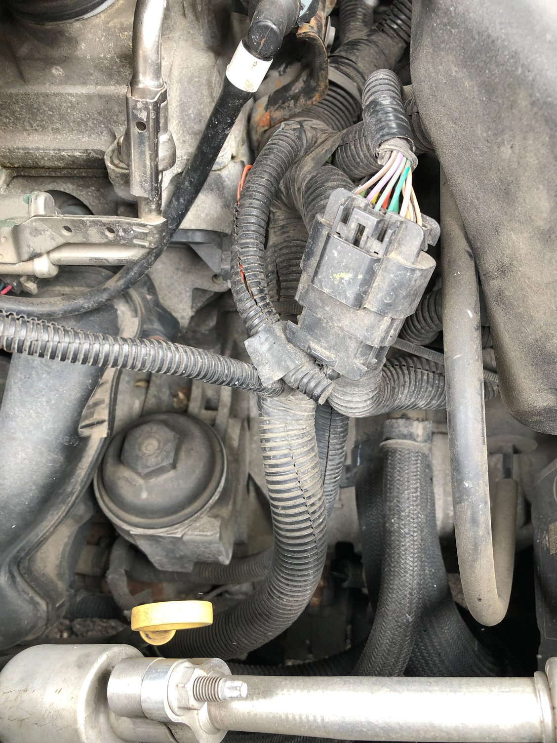

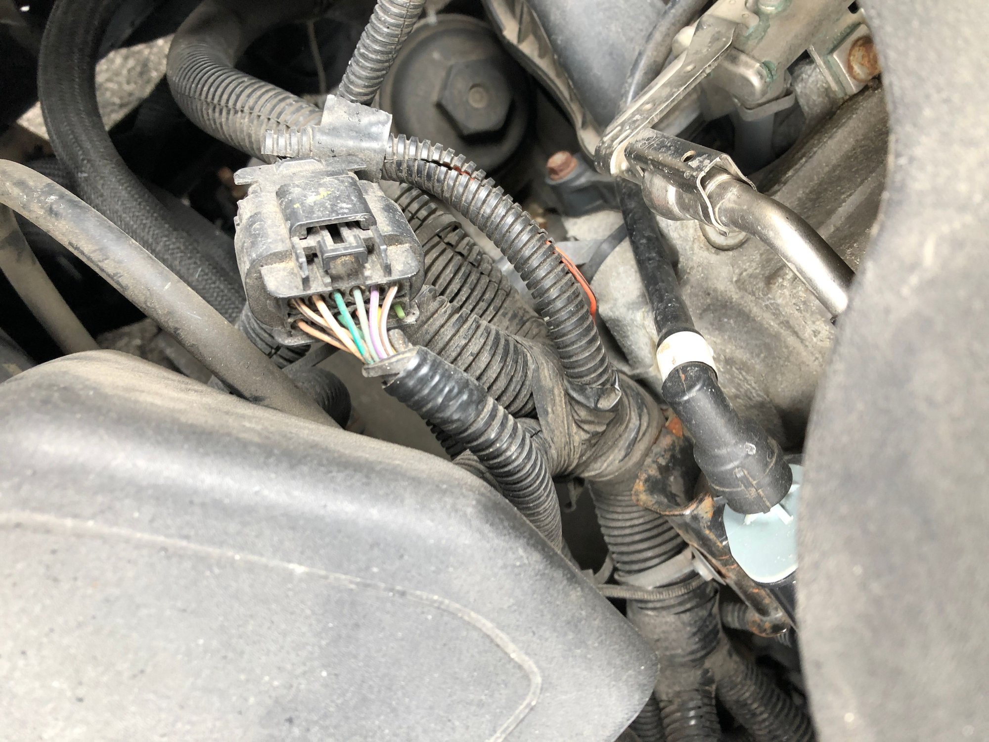

Here’s a few pictures of my 2.4 harnessing
