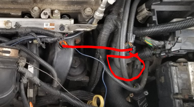

Originally Posted by donbrew
I think the MAF connector (red circle) is plugged into the harness plug that should connect like the red line?
I was able to identify that connection, they spliced in the correct connector for the throttle body they have on it.
