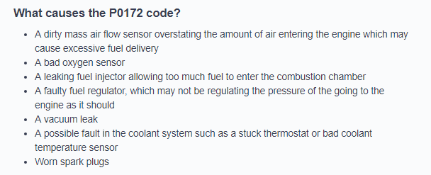

Old Sep 9, 2017 | 05:09 PM
Posts: 26,532
I do.
I would focus on vacuum leaks, including the EVAP purge valve being stuck open.
