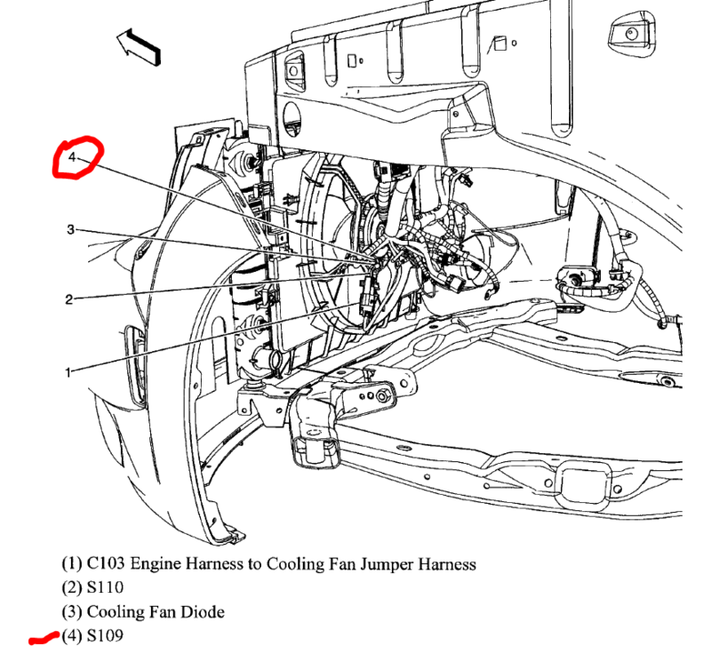

Year and model?
Depending on the exact production date there may be a diode on the fan wiring.
There may also be a relay in position #50 in the underhood fuse box.
The diode would be my first guess, if you have one.
The diode is spliced into both wires at #2 & #4, probably wrapped up in tape.
I will check that out in the morning donbrew.......Thx

Update....as donbrew suspected it was the diode....I did disconnect it but I did not reset the check engine light as I did when I did the fan itself...my bad....assumed the fuse blew again because light Was still on.....lesson learned.....Thx again donbrew
