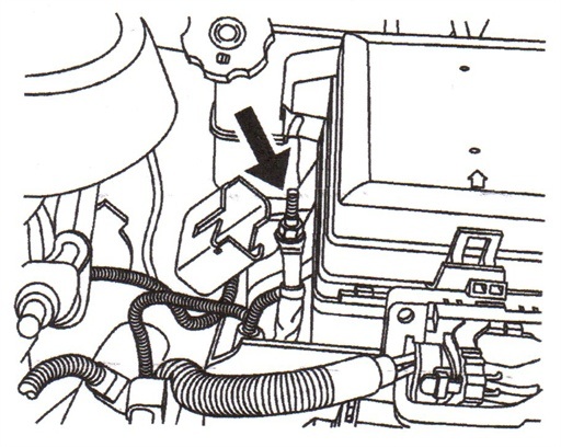

check your underhood fuse panel to ensure the two halves are connected tightly, tighten the nut under the red power post, remove the negative battery terminal in the spare tire trunk for 30 minutes, reconnect and ensure it is tight, this could be the end of the life of your battery, as for #2 go to your GM dealer and advise them you have had the light come on, they will check your VIN, and address the power steering motor.

X2. Oldblue You covered them all here is a pic of the battery connection to check and clean. Mine was slightly loose and it created all kinds of strange things to happen.

Thanks for the advice. I was actually thinking I should have the battery tested on my lunch break. I've replaced the battery once, but it was probably 3 years ago.
Anyway, I'l check those connections. I put a new power steering motor in myself a month or so ago.
