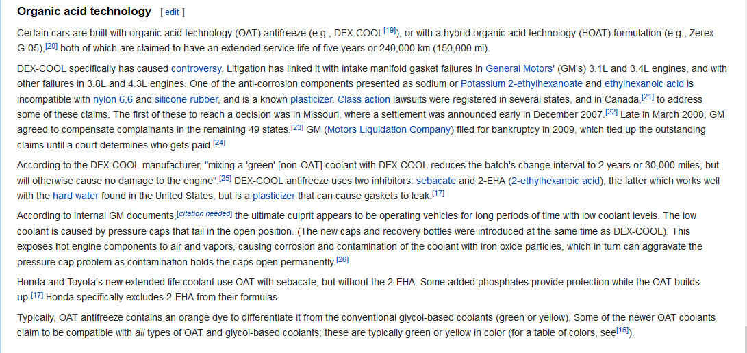

If the temp has ever gotten over 240F or or so DexCool tends to crystallize and get clumpy. I assume it is attempting to plug leaks, but it stays that way until flushed and replaced. (personal experience)
Here is an excerpt from WIKI:
