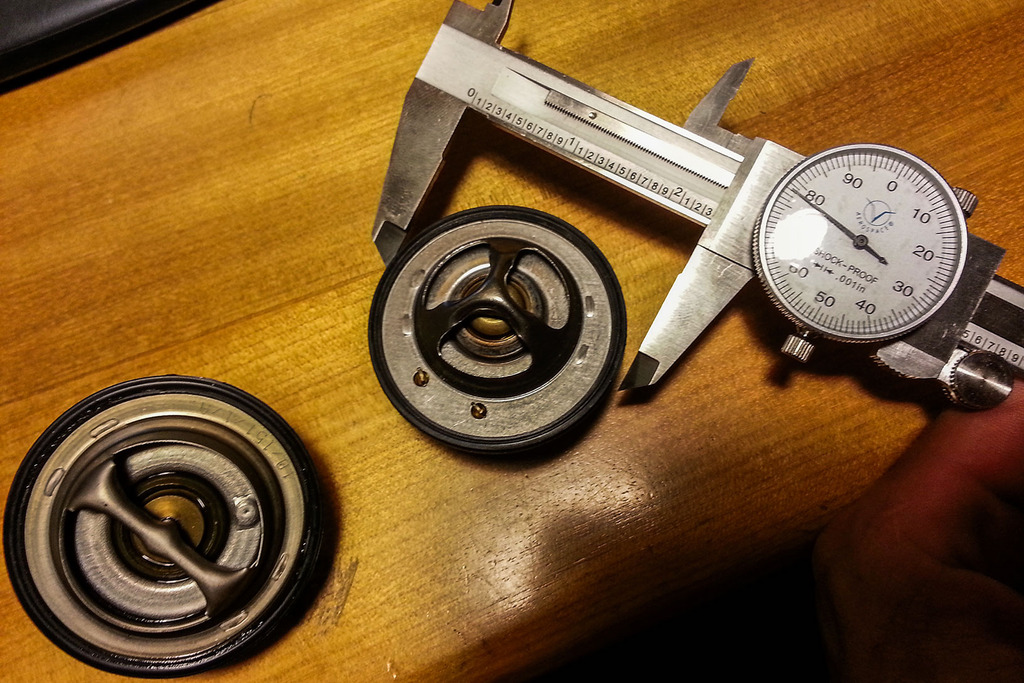

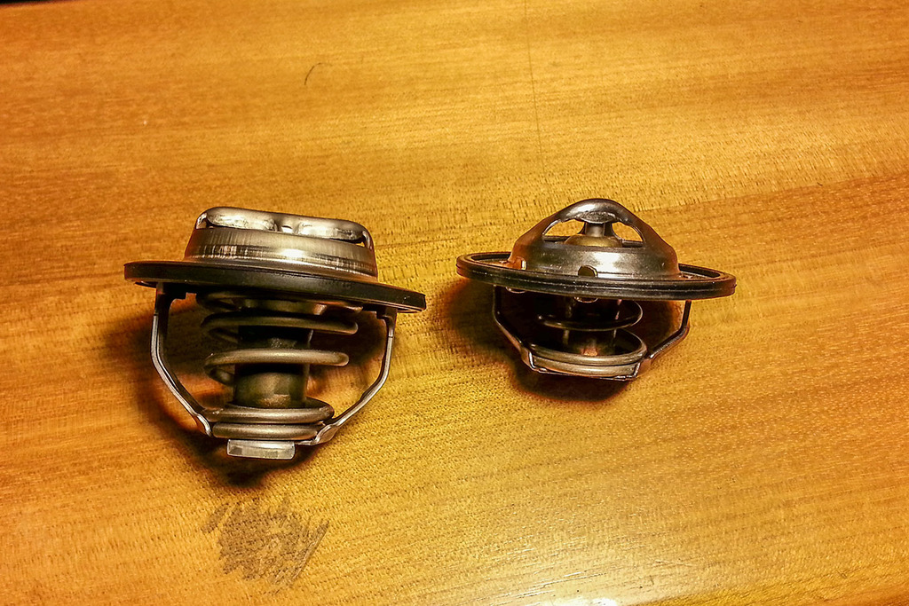

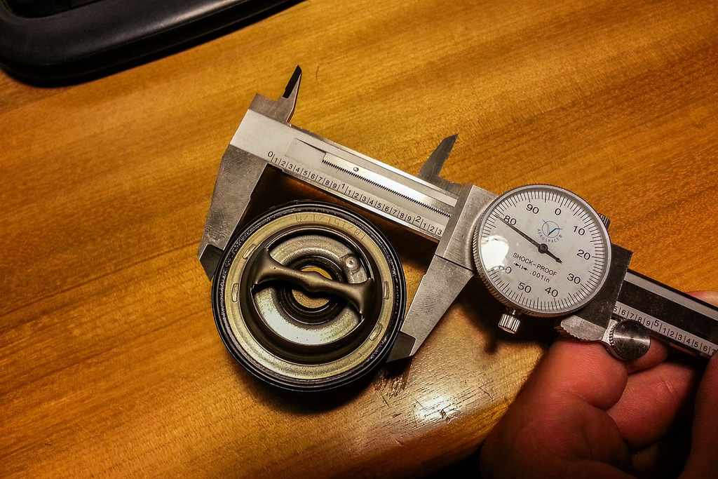

Sorry if I am being repetitive. I measured the thermostat that I got from https://www.amazon.com/gp/product/B0...?ie=UTF8&psc=1 and it is a little smaller than the original in every way. The gasket is the same as on the older one. As far as thermostats go, are these dimensions critical?
Here are a few pictures:

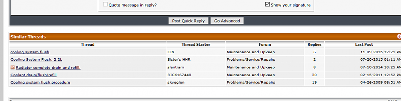

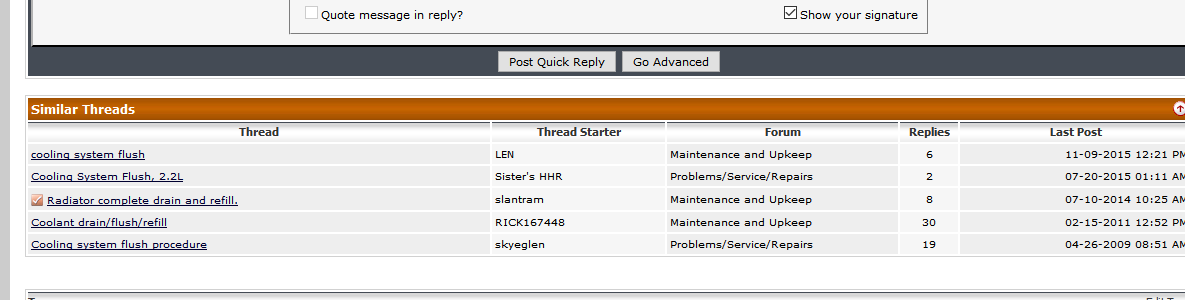

Looks wrong, how does it fit in the housing?
Why not just do as advised?
Look down at the bottom of the page to see if this is repetitive.

I looked through all of these threads before to gather information on the basic steps in the process. The questions that I am asking are just tiny details that are not mentioned in the threads above. Frankly, it is a bit of a task to do coolant drain/flush/fill along with thermostat change for a person who is doing it for the first time. Just want to make sure that everything was done right the fist time and then just forget about it for the next 5 years.
All the advice I got is truly valuable, but not all the questions can be answered. I will just drop it in and let you know how it goes from there. If, as RJ_RS_SS_350 mentioned, that part used to be an old version of the same thermostat, then it should work fine.

Or, the wrong part in the right box. Happened before.
Did you buy the car brand new? If not, that may not even be the original thermostat you're comparing to(could be an aftermarket).
