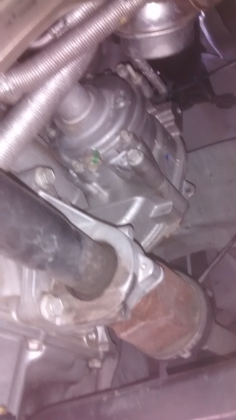

I just took this pic. This is the SS, you may have something in the way. I think the drain bolt is the one with the dab of green paint. Someone tell me if I'm wrong please.
It's on the passenger side, between the engine block and the firewall, above the axle shaft.

That is it. the paint is QC check mark.

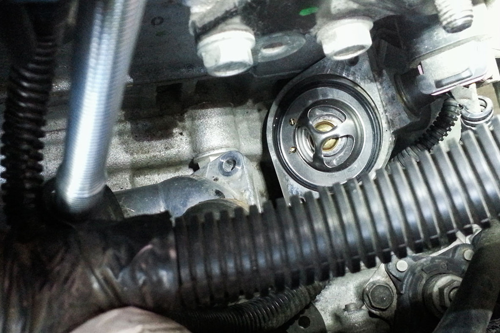

I went ahead and did what firemangeorge suggested. Almost the entire gallon of Dexcool went in after burping the system for some time. Going to drive the car for several days adding the remaining amount of Dexcool and distilled water.
Thermostat went in just fine. There is a little gap since the diameter is slightly smaller than the original.

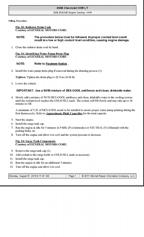

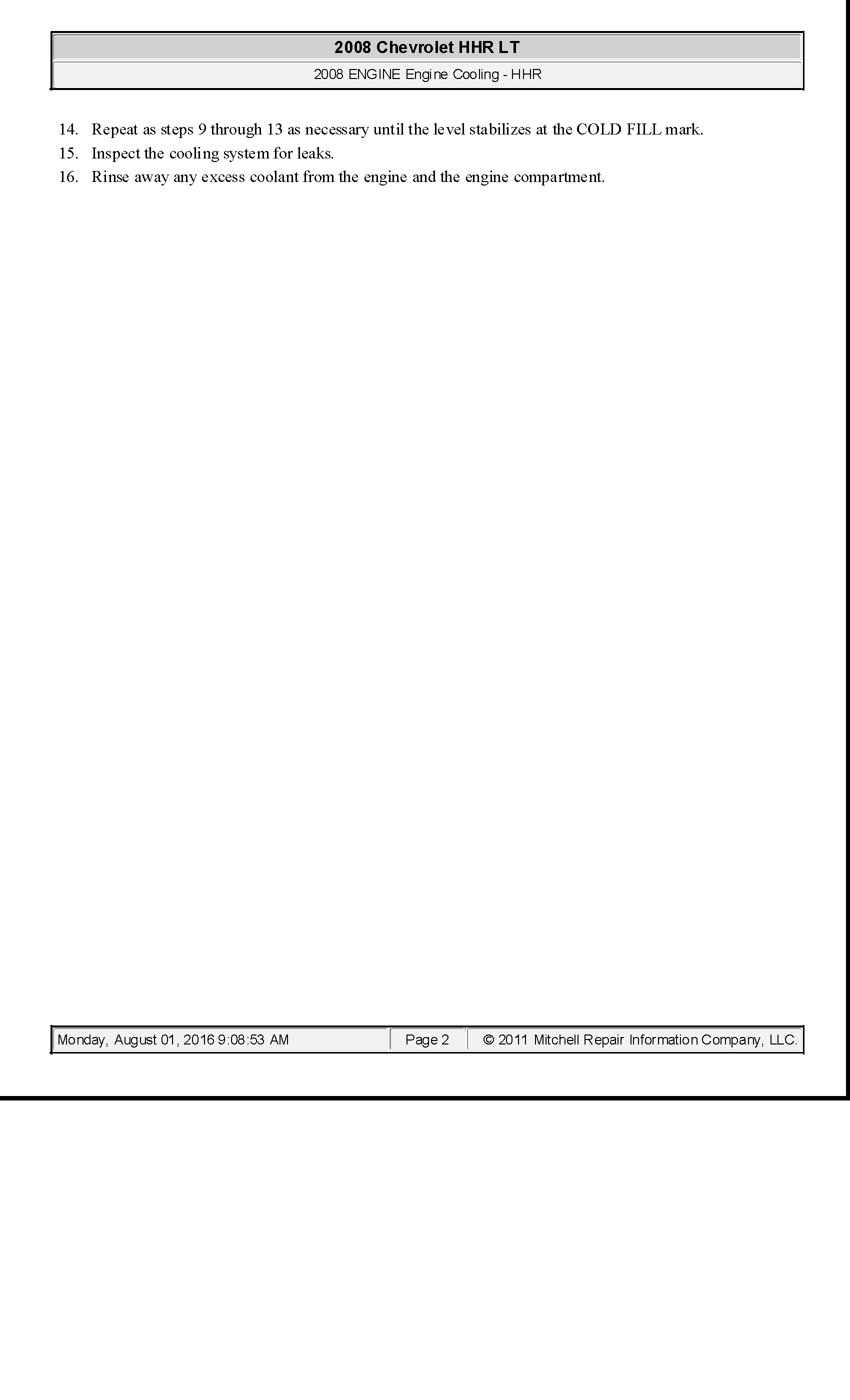

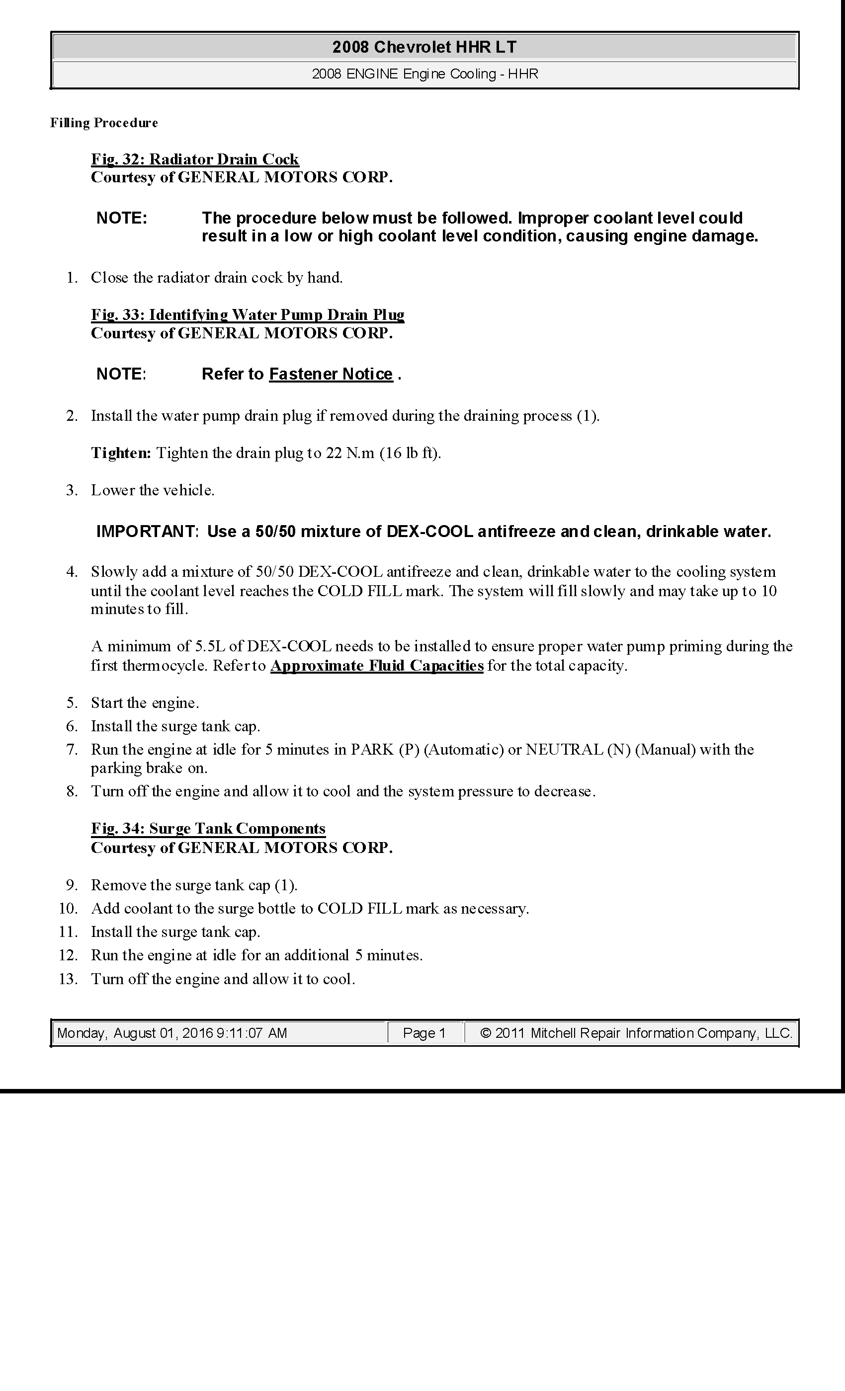

DO NOT use chemical flush agents. Aluminum! It may not clog up, but it roughs up the surfaces making for bad flow.
Dex-Cool has no silica.
For static drain you must remove the t-stat.
It comes from the factory with some sort of sealant and it is really on tight.
16 lb in / 22 N.m. is correct according to Mitchell. (DAMN MY LYING EYES, IT IS 16 LB. FT.)
For some reason GM thinks they put surge tanks on 2008 models.

Slonny that stat is the wrong size! Possibly a customer returned the wrong stat in the expensive package! I've opened the box at the parts counter and found a Stant t-stat in an AC Delco box, it happens!

I am speechless... Everything is in place now and I am so tired of all of this fixing/maintenance that I a need a few weeks to recover. I emailed the person who sent me that thermostat about the issue that I am having.
It looks like I will need to go through another drain/remove thermostat/fill process, but that is for another day. I will just reuse the coolant that is already in the system and top it off with 50/50 mix.

You do not have to drain the system to remove the t-stat! Just pop the housing lose a couple tablespoons of coolant. 2 bolts.
You are making too much out of the job. It is not magic or rocket science.
