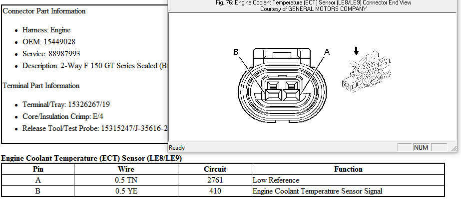

donbrew Jun 25, 2019 06:19 PM
Polarity?
https://cimg8.ibsrv.net/gimg/www.che...bba6463a86.png

The code i had was the p0128 . As far as polarity goes i matched the wires to the plug so that i connected the wires with both plugs in the same position and did one wire at a time to make sure of no mix ups. Right now the temp gauge is reading correctly when compared to the coolant temp on a scanner. But now the the ac does not work and the gauges are jumping. The sensor i removed had makings of Delphi 126 , the second sensor was an ac delco sensor 213-4514 i believe was the part number.
donbrew Jun 25, 2019 07:07 PM
Note that it is not exactly polarity that counts. If the 5V ref gets shorted everything goes crazy.
The brand and part number of the t-stat is very important ACDelco 131-158
