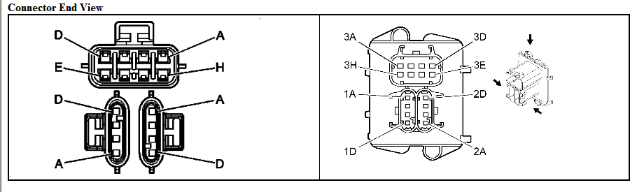

AND you have checked fuse #64 under hood?
I think the pigtail plugs into a harness end before it goes inside. 3 circuits all plug into the harness. That could be a failure point.

Yes. I did check fuse #64 and it's good on both sides. The pigtail does plug into a connector on the underside of the car. I probed that too and there is no power there either.

If the ground wire is hot; yes short to voltage. The last you said was no +, now it's both +?
If you mean you spliced + on one side and now both sides are + the short is probably in the connector or at the original splice. Try continuity between the 2 pins.
The valve that was OE on 2006 used a different connector and you had to get an adapter pigtail to make a new valve work. I wonder if somebody got a junkyard valve from a 2006 and modified the wires? The parts stores sell the pigtail adapter, some new valves come with it.
The bundle probably runs under the door sill molding except where it cuts around the driver seat support.
