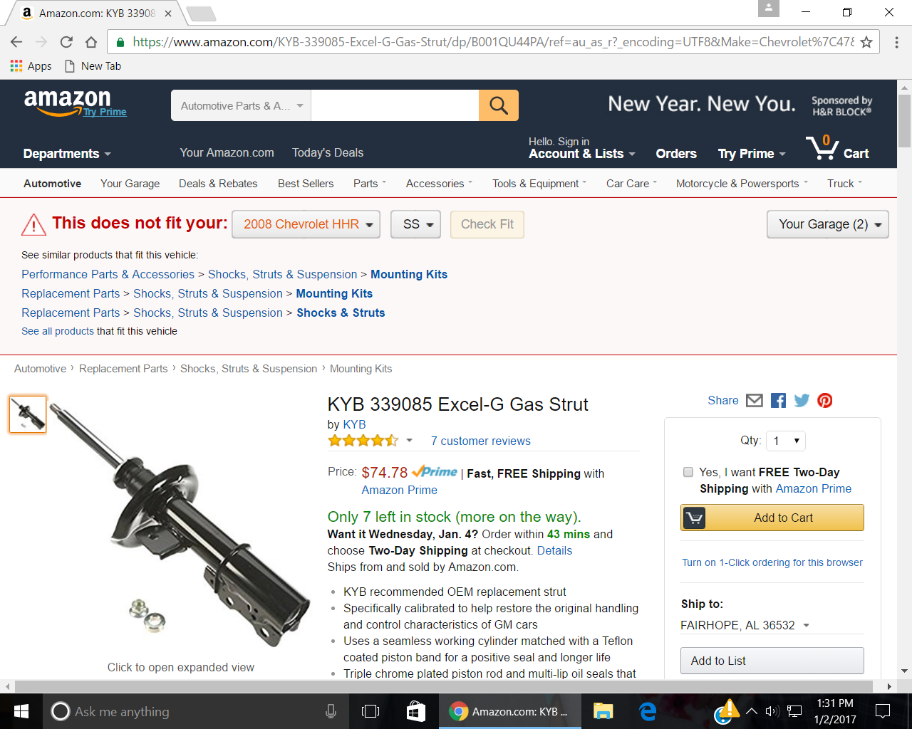

According to this those struts are not SS but general HHR , not that there's anything wrong with them , just not SS specific
KYB 339085: Front GR-2 Strut Chevrolet/Pontiac | JEGS
Click on vehicle figment.
Sway bar bushings will knock and bump, cv joints will rattle and hum! Not in U2 fashion!
Old Jan 2, 2017 | 01:39 PM
Posts: 11,721
"339085 and make is KYB excel G strut"
Those are the WRONG struts for a SS. That part is for a FE1 suspension. They're too soft for the FE5 suspension on a SS.

Ok i will order the right one's its hard to find a true FE5 when ordering online do you have any idea's on where to get them from
Old Jan 2, 2017 | 01:46 PM
Posts: 26,532
Go back to your first thread on the subject, there is a lot of discussion on where to get the right ones.
Rear hubs have been suggested more than once in this thread.

Posts: 40,083
Use the GM numbers
https://www.chevyhhr.net/forums/comm...-part-i-48833/
In case you missed this
