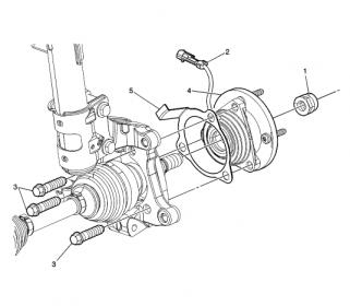

Just in case the link doesn't have this pic. Although it likely does..
Just curious where you got this illustration. I lost one of the bolts marked #3 in the illustration, also known as a hub bearing bolt and can't find one in any of the parts stores I've gone to. Anyone have an idea what a part number this is or where I might find one besides a junk yard? Thanks.

Your GM parts counter or find it in this list
http://www.wholesalegmpartsonline.co.../11517996.html
