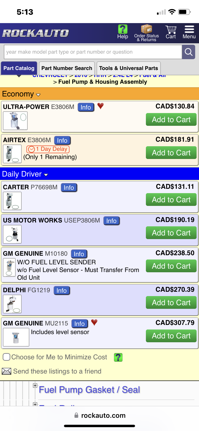

run/ set-up from the pump to first disconnect about 30" long? Again, some pumps come with these lines MADE on to the pump and Quick-Connections on the other end. Also does anyone have a good report on a fuel pump OTHER than a stock GM one or AC Delco... Brand name and place to get it.

As for fuel pumps, they are all pretty much the same, probably made in the same factory over seas, I have only installed GM pumps as they are complete with fuel sending unit and float
The Ultrapower also includes the float and level sensor same as the GM at nearly 3 X the price

Airtex has a general bad reputation.

As I said, I’ve only installed GM , more expensive but I’ve never had a failure with them.

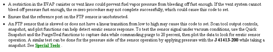

Here are other things to suspect:

https://www.obd-codes.com/p0451
Check the canister filter for any damage, the fuel tank pressure sensor should be new and came with the new fuel pump assembly
