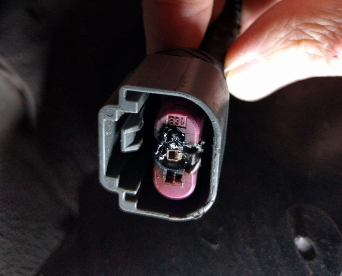

Old Apr 22, 2025 | 01:18 AM
SwissHHR's Avatar
Joined: 01-14-2014
Posts: 145
From: Switzerland
That's the reason for the intermittent headlamp outages... Whatever the cause for this charring is...
What kind of plug do I have to look for as replacement? Maybe someone here can recommend an eBay link?
