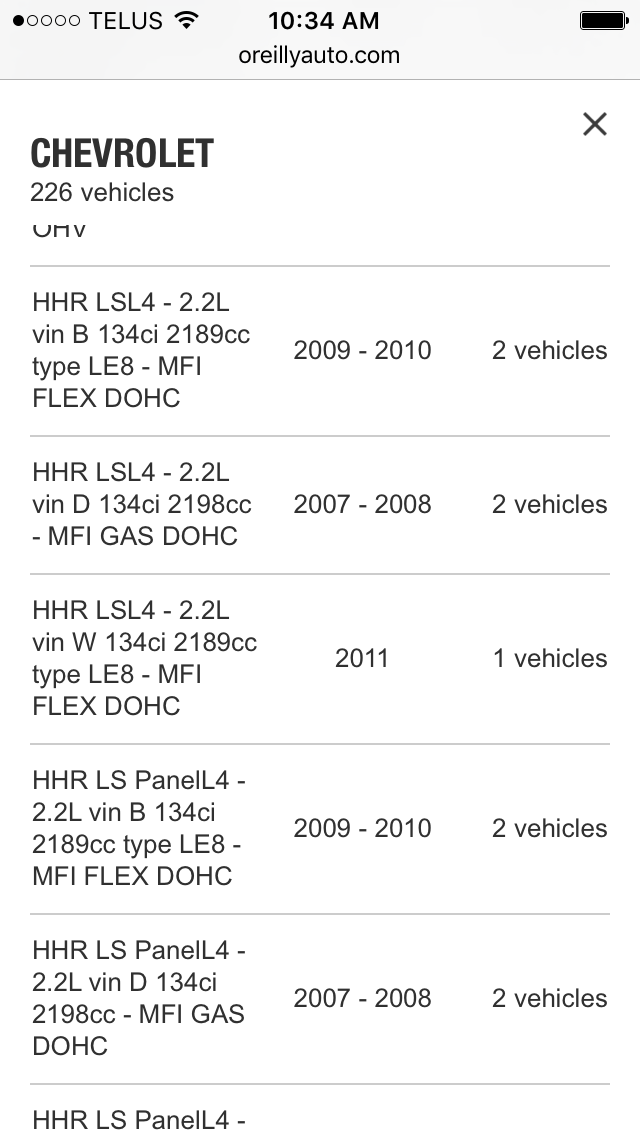

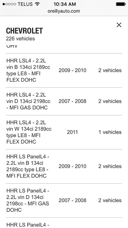

Hmmm, tap on compatibility and the MAP sensor shows for 2.2 and 2.4 HHR's
http://m.oreillyauto.com/h5/r/www.or...2203&ppt=C0033
