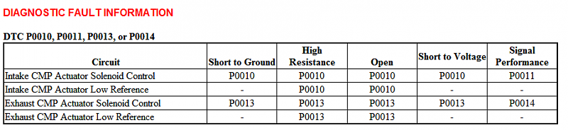

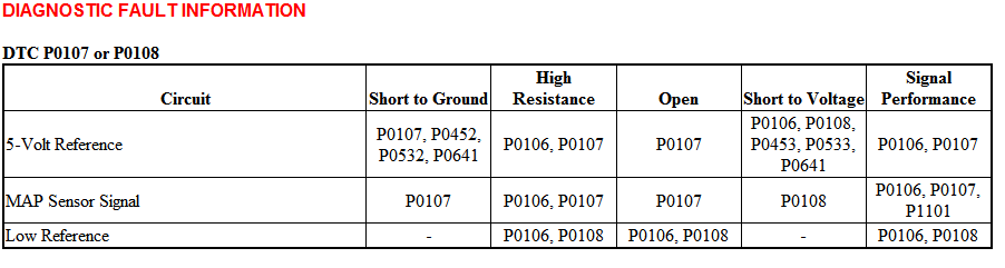

compare these 2 charts note the similarities:
I guess if the exhaust valve sorted internally it could make the MAP malfunction.
