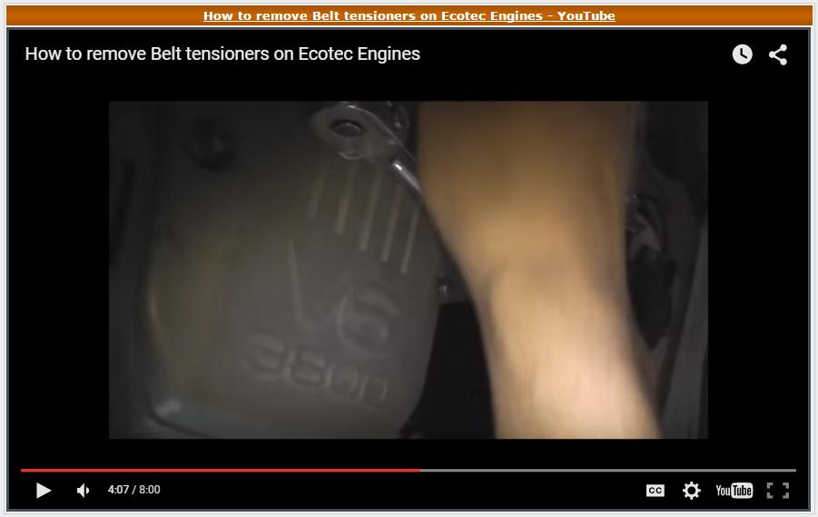

I found this how to for you
Most tensioners for the accessory drive belt are used for $20. To $30.00.
Did not find a new one online but I'm sure somebody will

Ummm.. you do realize that engine in the video is a 3800 V-6 longitudinally mounted engine vs. our shoe-horned with grease 2.0-2.4 I-4 transverse mounting? First clue was the extension on the rachet for the pulley .... for a HHR ???
p.s I'm sorry, couldn't resist the temptation...

Then the title is misleading, arrrggggh !
