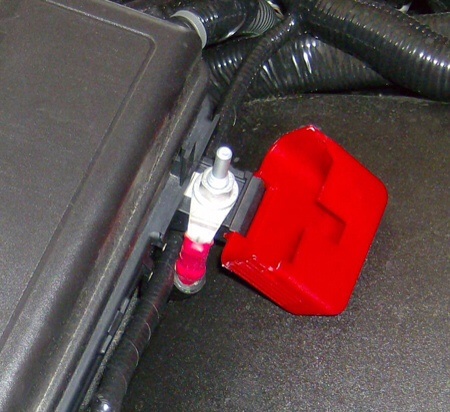

Old Jan 26, 2016 | 11:45 PM
Lucky's Avatar
Joined: 12-24-2007
Posts: 2,873
From: Seville. OH
Check this connection they are known to loosen up.
