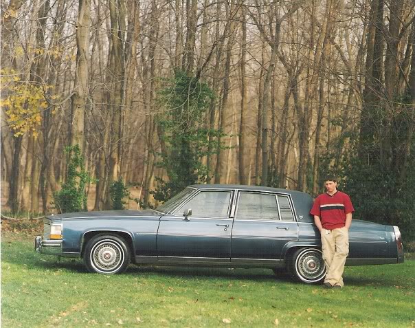

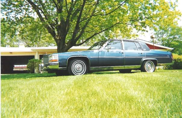

I had a 1988 Fleetwood Brougham in high school-car only had 13,000 miles on her. I loved that car. It sat for 9 years in an old man's driveway with about 40 bags of mulch all over it-I ended up buying it from his wife after he had passed. That car was naval blue metallic from the factory, but when I got it, the color scheme looked more like mahogany and bird ****. He was holding on to it for me to get the $200 together that he wanted for it (when you're 15, that's a lot). The car was initially owned by his late father-in-law who was an agent for the FBI. I found an SW .380 under the driver seat. That's a story for another time...
No air in the air ride, rear end was flat on the ground. The only rust she had was a perfect hole where a neighbor kid shot it in the passenger side door with a BB gun, dead middle. The hole was very small initially, but after a while, the rust traveled under the paint surface and created a blister the size of a dinner plate. I cut the section out with a grinding wheel, treated with the acid, brazed in a plate, ground the seams smooth and treated again with the body acid. Bondo fill, primer/paint clear, pinstripe, sweet.
Had the car from 2002 to 2010. No rust or blistering ever happened in that spot, or inside the door. I checked on more than one occasion. I got rear-ended by a teenage girl on her cell phone. That killed my baby. :'(
One of my senior pictures.
I miss that old girl quite a bit
