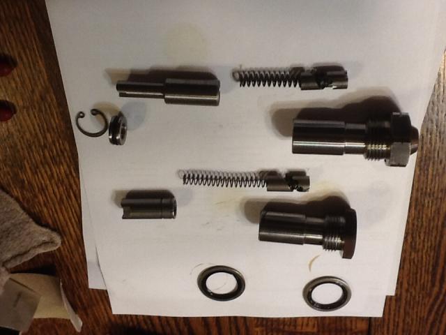

The new updated tensioner is built different that the old tensioner but still requires the same install proceeder. Here is a picture of the new and old tensioner disassembled

Sorry the picture is up side down. Some day I will learn how to fix that.

im still reading the other thread, it was 6 pages, plus reading about engine swaping etc. so if its more then just swap engine.. so i need to put it out and redo it... however that still doesnt explain why you can hear the knock/slap with valve cover off and chain at tight state.
