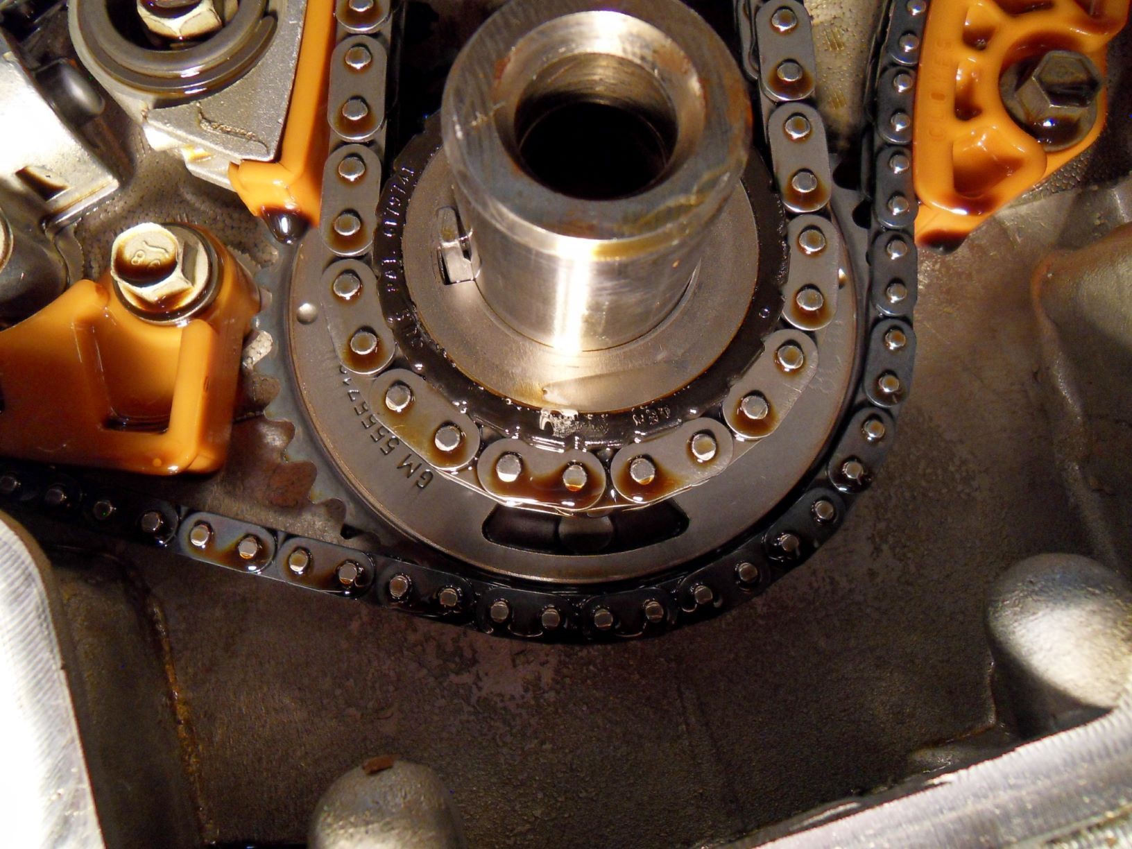

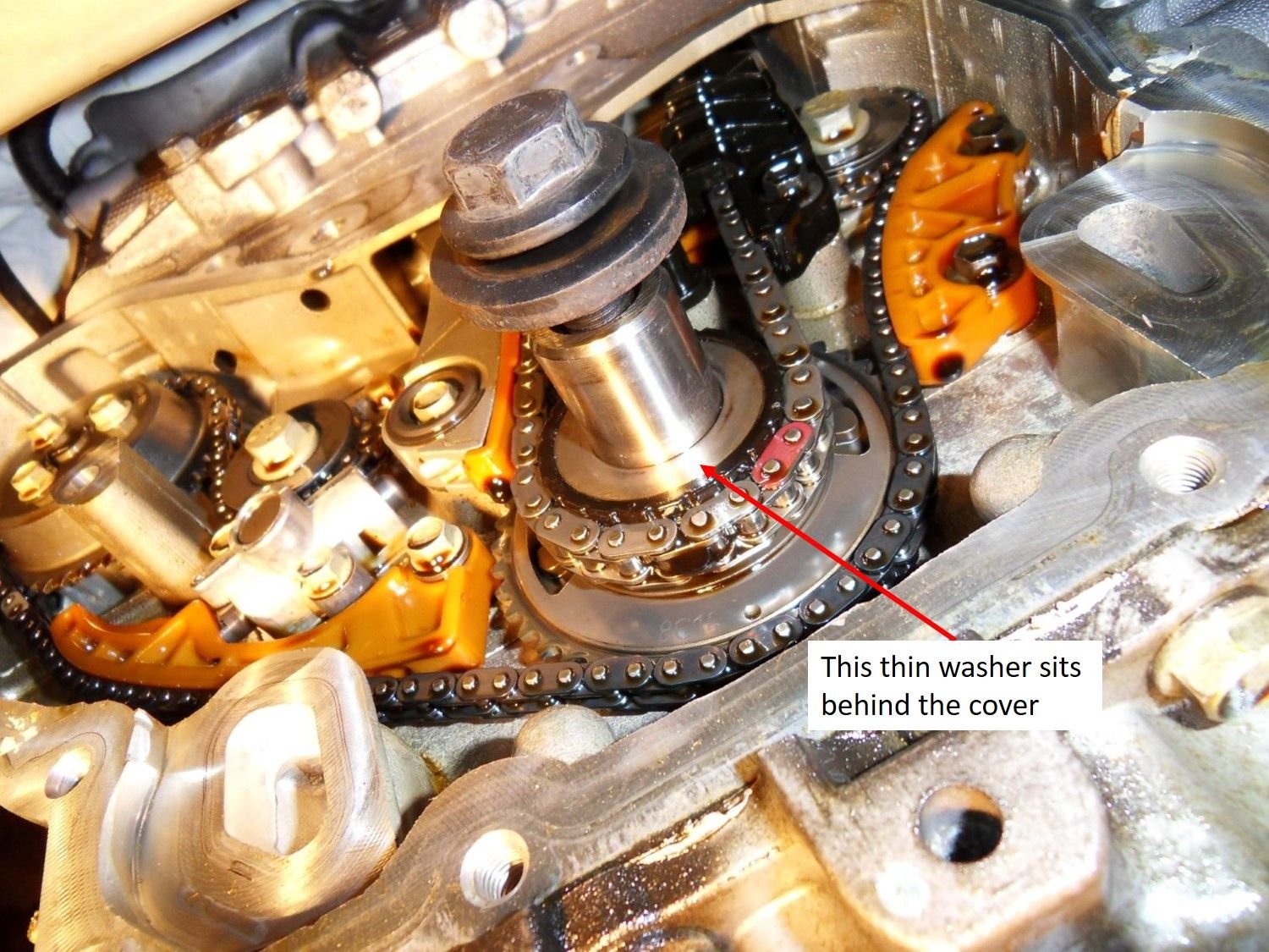

Maybe this thin washer that I believe has a keyway notch and sits behind the cover. It's been a while since I performed the timing chain project.
Thin Crank Washer
Thin washer with keyway notch

The rubber washer is not part of this assembly, set it aside just in case it fell off from somewhere else.
When the front seal was replaced, the front cover would not have been removed. The thin washer that rlee is referring to would not come into play either.
