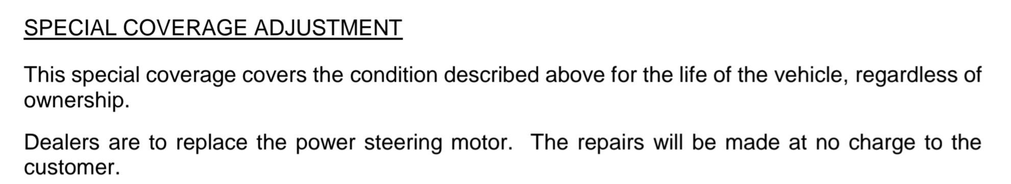

Someone else pointed out the 10 year limit , from the USA 🇺🇸
https://www.chevyhhr.net/forums/gm-r...s-63438/page2/
It’s in here post #15 perhaps someone can post a copy from GM USA.
I don’t see why the limits of the offer would be any different.
I did find this , but it’s not from GM, approach a GM dealer, perhaps they will comply
https://static.nhtsa.gov/odi/tsbs/20...90453-2280.pdf

TLDR - With any non-turbo HHR power steering failure, go to any GM dealer and insist on a free repair. Persistence may be needed, but it will probably work.
There was and extended warranty that was so long it might as well be lifetime. 999,999 miles or through 2040 or something. Also a recall. Which applies depends on the year. Most non-SS HHR's are covered, but I have seen reports of $0 repairs even for the few non-SS cars that are technically not covered. Apparently GM really really doesn't want you to die due to a bad ps motor.
Any GM dealer can address this. Some have never heard of this, so make sure they check for both the recall and the extended warranty. By all accounts, persistence pays.
These are $0 repairs, but there are many reports of dealers trying to tack on bs charges.
