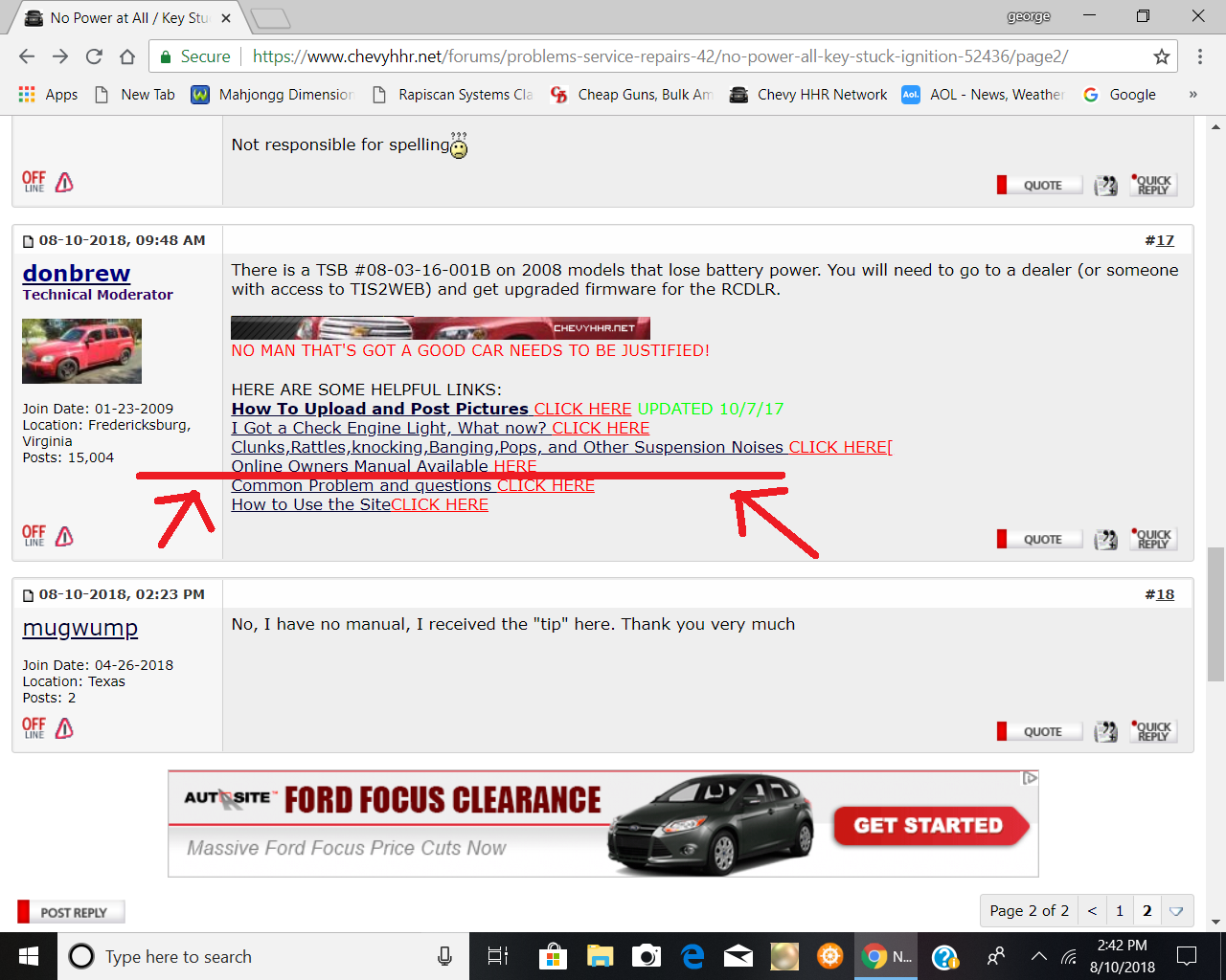

Old Aug 10, 2018 | 02:50 PM
Posts: 11,721
Online Owners Manuals are available for you to download on this site. Moderator Donbrew has a link in his signature. Click on the link and find the manual for your year model.
