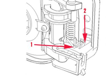

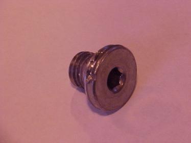

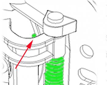

Further inspection will show that the oil leak is coming from the center oil galley plug.
Recommendation/Instructions

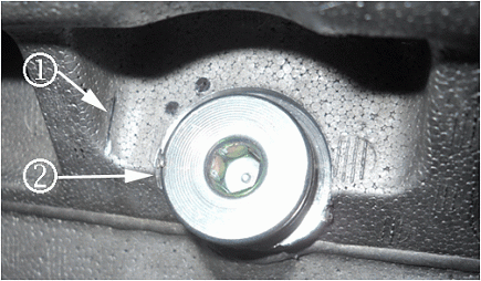

The center oil galley plug may have been damaged during installation when the engine was built.
There may be a witness mark (1) and damage to the galley plug (2).
Replace the oil galley plug.
Remove the exhaust manifold. Refer to the current procedure in SI for removal.
Remove and replace the center oil galley plug. The plug should be tightened to 35 Nˇm (26 lb ft).

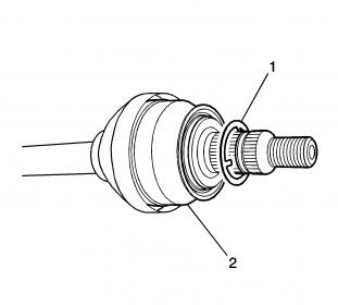

Add a washer between the front wheel drive shaft and the bearing hub assembly using the procedure listed below.
Note: • Some vehicles may have been built with the washer. If there is a washer already installed, remove and discard the washer. DO NOT re-use the washer, replace with NEW only.
• Anytime the wheel drive shaft is separated from the steering knuckle, the washer must be replaced with a NEW washer only.
1. Remove the front wheel bearing and hub assembly. Refer to Front Wheel Bearing and Hub Replacement procedure in SI.
2. Install the washer (1) onto the front wheel drive shaft (2) as shown above.
Note: For Cruze, Equinox and Terrain, DO NOT reuse wheel drive shaft nut. Discard and replace with a NEW nut only.
3. Install the front wheel bearing and hub assembly. Refer to Front Wheel Bearing and Hub Replacement procedure in SI.
4. Repeat Steps 1 through 3 for the opposite side.

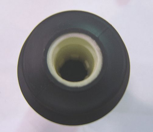

Some customers may comment on a clunk or thump noise coming from the front suspension while driving over rough road surfaces. This noise will typically occur when the front suspension is returning to the upward position after a hard downward stroke, such as after driving through a large rut or pothole.
Cause
This condition may be caused by the jounce bumper slamming into the upper spring seat because it is not retained in the correct up position. The jounce bumper loses position due to oil being deposited onto its retention fingers. The oil is from the strut leaking.
Correction

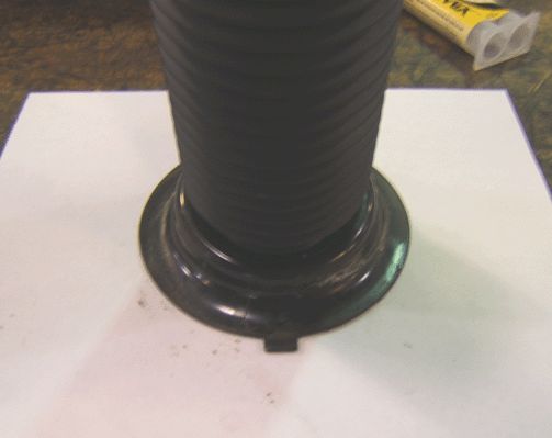

Inspect the front strut(s) for evidence of oil. The leak may be slight but will still cause the concern. If oil is present, replace the affected strut, jounce bumper and dust boot (shield). Before reassembling the strut assembly, glue the new jounce bumper and new dust boot (shield) to the upper spring seat using the steps listed below. To further confirm this concern, the shield/bumper will easily slide up and down the strut shaft.
1. Clean the surface area of the upper spring seat using fine sandpaper.
2. Apply a light coat of *3M™ Automotive Adhesion Promoter, P/N 06396 or equivalent, to the top of the dust boot (shield) on the inside edge and to the top of the bumper. Allow to dry 10 minutes.
3. Glue the bumper to the inside of the dust boot (shield) as shown. Use *3M™ Duramix™ Super Fast Adhesive, P/N 04747 or equivalent. Allow to cure thoroughly 5-10 minutes at room temperature.
4. Apply a light coat of *3M™ Automotive Adhesion Promoter, P/N 06396 or equivalent, to the top of the dust boot (shield) and to the upper spring seat surface. Allow to dry 10 minutes.
5. Glue the dust boot (shield) to the upper spring seat as shown using the above recommended adhesive. Allow to cure thoroughly.
*We believe this source and their products to be reliable. There may be additional manufacturers of such products. General Motors does not endorse, indicate any preference for or assume any responsibility for the products from this firm or for any such items which may be available from other sources.

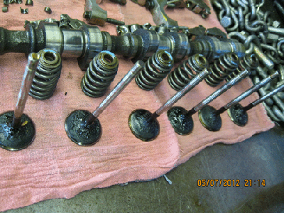

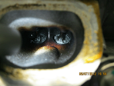

#PIP5029B: Engine Misfires Due To Major Carbon Deposits On The Intake And Or Exhaust Valves - (Sep 24, 2012)
Subject:
Models:
2009 - 2013 Buick Enclave
2009 - 2013 Buick Lacrosse
2008 - 2013 Cadillac CTS, STS
2010 - 2013 Cadillac SRX
2013 Cadillac ATS, XTS
2008 - 2010 Chevrolet Cobalt SS, HHR SS
2009 - 2013 Chevrolet Traverse
2010 - 2013 Chevrolet Camaro, Equinox
2012 - 2013 Chevrolet Impala
2009 - 2013 GMC Acadia
2010 - 2013 GMC Terrain
2007 - 2010 Pontiac Solstice GXP
2009 - 2010 Saturn Outlook
2007 - 2010 Saturn Sky Redline
With any of the Following Direct Injected Gasoline Engines:
2.0 (RPO LNF)
2.4L (RPO LAF, LEA, or LUK)
2.8L (RPO LAU)
3.0L (RPO LF1 or LFW)
3.6L (RPO LFX or LLT)
This PI was superseded to update photo and part numbers. Please discard PIP5029A.

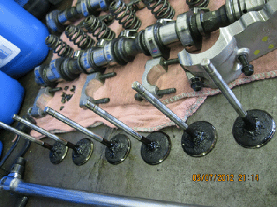

The following diagnosis might be helpful if the vehicle exhibits the symptom(s) described in this PI.
Condition/Concern
Some customers may complain of a MIL and engine misfire. In some cases, the misfire may be more apparent on a cold start, may count on a single cylinder or several cylinders, and may or may not be felt by the driver. Upon inspection, the technician will find one or more misfire codes (DTC P0300-P0306) stored in the ECM and SI diagnosis may or may not isolate the cause of the misfire depending on whether the intake/exhaust valves are sticking at the time of the diagnosis.
This may be the result of major carbon build up on the intake and/or exhaust valves as shown below so the misfires should not have appeared until at least 5,000 miles or more.
If this concern is encountered, perform SI diagnosis. If SI diagnosis isolates a valve sealing concern and/or eliminates everything else external to the engine, decarbon the engine with Upper Engine and Fuel Injector Cleaner by following the guidelines below:
Important: Extreme care must be taken not to hydro lock the engine when inducing the cleaner, especially if it is induced without Kent Moore Tool # J-45076 / J-35800-A or equivalent. If too much cleaner is induced at too low of a RPM, or if you force the engine to stall by inducing too much cleaner at once, the engine may hydro lock and bend a connecting rod(s).
1. In a well-ventilated area with the engine at operating temperature, slowly/carefully induce a bottle of GM Upper Engine and Fuel Injection Cleaner into the engine with RPM off of idle enough to prevent the engine from stalling (typically around 2,000 RPM or so). Depending on the engine configuration, induce the cleaner through the throttle body or an engine vacuum hose/pipe. For best results, it is suggested to induce the cleaner through the throttle body with Kent Moore Tool # J-45076 / J-35800-A or equivalent (shown below).
2. Turn the engine off after inducing the cleaner and allow the cleaner to soak with the engine off for 2.5 to 3 hours (Do not let cleaner soak for more than 3 hours as remaining deposits may start to harden back up again).
3. Add a bottle of GM Fuel System Treatment Plus to the fuel tank and fill the vehicle with one of the Top Tier gasolines listed at http://www.toptiergas.com and/or in the latest version of 04-06-04-047 (USA) or 05-06-04-022 (Canada). See Bulletin 05-00-89-078 for more details on GM Fuel System Treatment Plus.
4. Test drive the vehicle extensively to circulate the GM Fuel System Treatment Plus.
5. Re-evaluate the concern to determine if it is repaired or improved at all. If the concern is improved but not repaired, it may be necessary to perform the above decarboning process a 2nd time.
6. To complete the repairs, advise the customer to only use one of the Top Tier Gasolines listed at http://www.toptiergas.com and/or in the latest version of 04-06-04-047 (USA) or 05-06-04-022 (Canada) to minimize future deposits. It can also be recommended to add a bottle of GM Fuel System Treatment Plus at every oil change as mentioned in the latest version of 04-06-04-051.
