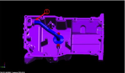

Engineering has determined that a machining concern with the oil pan pick up tube sealing surface may cause a low oil pressure condition. If upon checking the oil pressure (per eSI Oil Pressure Diagnosis and Testing) and the minimum spec of 50-80 psi @ 1000 rpm is not achieved (provided all mechanical causes have been eliminated) the oil pan may need to be replaced. Suspect engines were installed in vehicles within the following build dates (11/1/2008 to 12/31/2008).
(1) Suspect Area
Note: It may not be possible to identify the concern visually (the ID of the oil pan pick up tube sealing surface is too large). However if all mechanical causes have been eliminated and the vehicle was built within the dates above, replace the oil pan.
