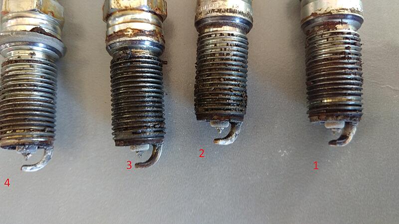

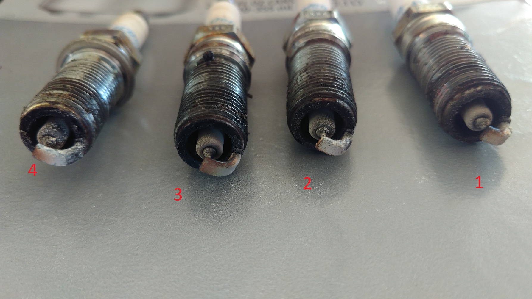

While I was there, I cleaned and swapped the fuel injectors around to see if it would make a difference and put new spark plugs in. This time I didn't put anti seize on the threads

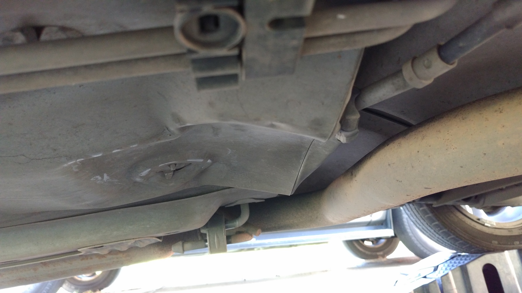

The lines from the canister look okay but I found this, looks like someone tried to use it as a jack point.

Wow - those plugs are toasted. The deposits around the whisker/center are odd - I've never seen that before. The new plugs were definitely in order.
(swapping the injectors and plugs were a great way to help the diagnosis - a lot of people spend unnecessary $'s and install a new injector or such)

That's the gas tank that is bent? Wow -

That is the floor pan that is bent.

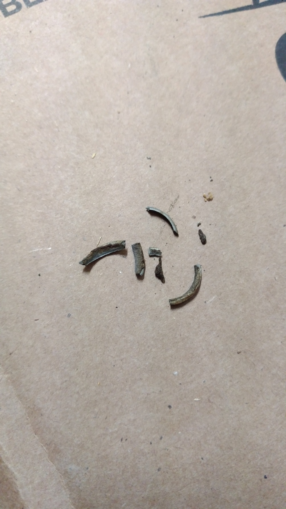

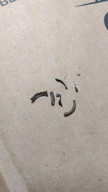

Why is there a washer on #4? The compression should be within 15% of each other.#3 looks like the one with the miss, but #2 is not far behind.
I dunno what that washer thing is I just noticed it. went and grabbed the plug, it flaked off... hope its not part of the housing! it was a little more difficult to remove than the other plugs...
