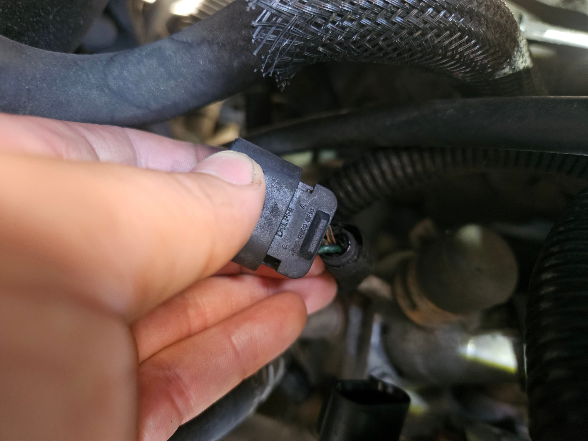

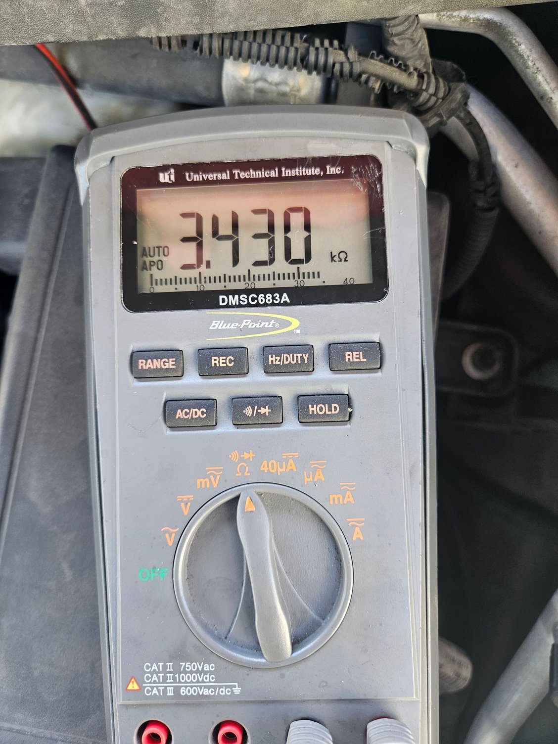

I checked for continuity at sesnors and connectors, of the intake camshaft and exhaust camshaft. Both readings are the same, sesnors are 11.6 ohms, connectors were 5.4m ohms, camshaft position sensor connector was 3.4k ohms at the white and green wire of the connector. I replaced the camshaft position sensor.
Is there a schematic for camshaft position sensor connector and where it leads to it? Looks like it leads to a module.

Why would the crankshaft position sensor have anything to do with this?
Where exactly was the 3.4K Ohm resistance? Between what to points?
You're barking up the right tree chasing this with an Ohm meter. Keep in mind it's an old car and there can be corrosion inside wire when the insulation looks fine.
3.4k ohms was at the camshaft position sensor connector wire green and white.
I don't know where is the other end of the camshaft position sensor wires.
