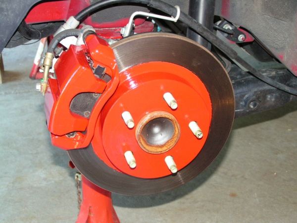

Here is a picture of our rear caliper and rotor assembly. That cable that is near that top being held by the steel loop is the Ebrake cable. When the lever is pulled it mechnically pushes the piston and shoe against the rotor. It obviously doesn't have the same force as the hydraulic pressure of the pedal itself, so it has to be kept in good adjustment...
