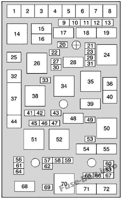

I was looking through the manual, but it did not seem to have any with the label EXH.

Not seeing it either
https://fuse-box.info/chevrolet/chev...uses-and-relay
Old Jun 13, 2021 | 08:47 PM
Posts: 26,532
#33 underhood.
Old Jun 13, 2021 | 09:35 PM
Posts: 40,083
Ah, the emissions fuse#33

Pulled, checked, and didn't notice anything strange with it. I swapped it for the spare fuse that is in the box lid and started car. Same Check Engine Light.
