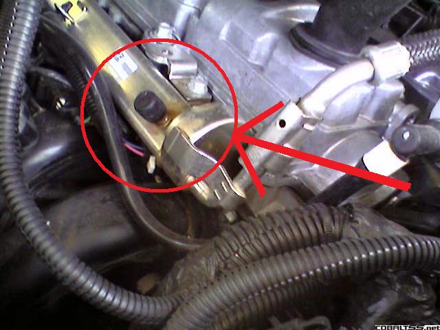

There are mutable things that can cause you problem. Checking the fuel pressures is not a bad place to start. You should be able to rent a fuel pressure gauge from a part store.
The fuel pressure gauge threads onto a port on the fuel rail. Here is a picture. The port is under the cap in the pic.
WARNING! DO NOT HOOK UP OR DISCONNECT GAUGE FROM PORT WITH THE ENGINE RUNNING.
Beware when you hook up the gauge some fuel under pressure may be released.

My car is having close to the same problem.... my car has not died but it has lost power while coming to a stop... it is also having trouble turning over. I wanted to know what the piece is that’s right by the arrow! It had a metal piece with a clip and a black hose! Thanks in advance
