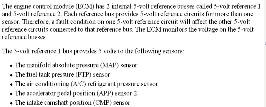

No other codes? Why replace chain? What about the MAP, Fuel tank pressure, AC pressure ands accelerator position sensor 2?
The salient bit:

If you messed with the sensors on the fuel tank there is a possibility that the pressure sensor wires got shorted which would short if the next module on the circuit is plugged in.
