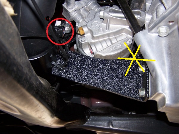

It is not under the car. I cited which fuse and relay to look for. The pump itself is near the vacuum assist.
As I said earlier; I think it may be the pump has malfunctioned. Especially because you SEEM to have never noticed before. But, you didn't acknowledge the question.
Old Jul 28, 2017 | 04:59 PM
Posts: 11,721
Hey Don.
Every thing I've seen and read on this site shows the pump mounted by the oil pan/block seam. Between the radiator and engine.
Most likely can't clearly see the pump from above.
It mounts somewhere close to here(yellow X's) where I added my charge pipe brace.
Disregard the red circle.
