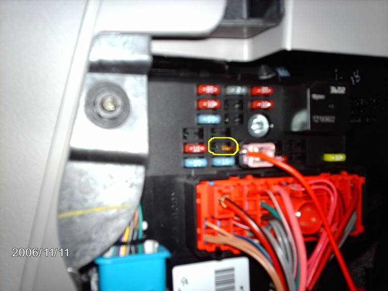

This open spot on the interior fuse panel is ignition on use. When the car is off and you open the door, it kills power.
That bolt you see on the side of the console is also a good spot to ground if you need it.
