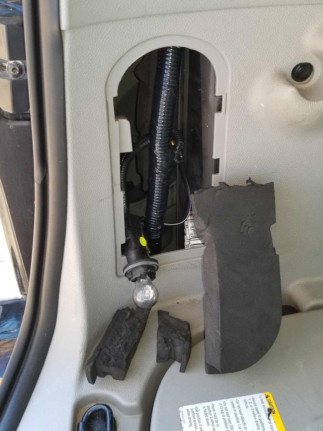

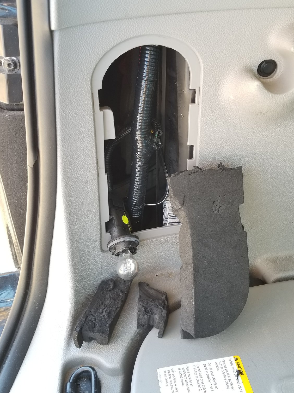

Donbrew, I got it done, but what a pain in the butt! My dad would’ve been proud that I didn’t hire someone to change a light bulb. I’ve attached a pic showing the 3 pieces of 1.25”-thick foam-rubber insulation that I cut out to allow access to the socket. I used pliers on the socket to remove it and reinstall it because the space is so cramped that I couldn’t get a good grip on the socket. Reinstallation was challenging to align the tabs and slots; my socket has a yellow stick-on label on the outboard side of the socket, which will be good to know the next time I change the bulb.
Without flash
With flash
