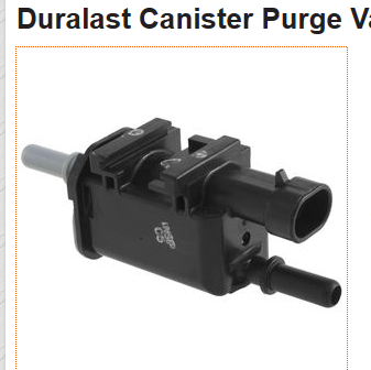

It lives attached to the driver side of the valve cover; one electrical connector and 2 air tubes.
The test is to remove it, blow into one end. If it is free flowing it is broken.
From https://www.chevyhhr.net/forums/comm...-part-i-48833/
Purge Vent Solenoid -(under the hood) PV443 (Duralast/AutoZone). About $20.
Readily available from other sources different prices and part numbers.

Alright, so I had it tested and you were correct donbrew, it was code P0171. I tried taking the EVAP purge vent solenoid out but could only get it disconnected. It seems like it's bolted on to something else? Do I need to completely unbolt that whole piece?

Okay, got it off, and can't blow anything through it. Which I'm assuming means that it is working properly.

There is a plastic bump that fits into a hole in the bracket, that you have to apply more pressure than you want to, to get it off the bracket.
