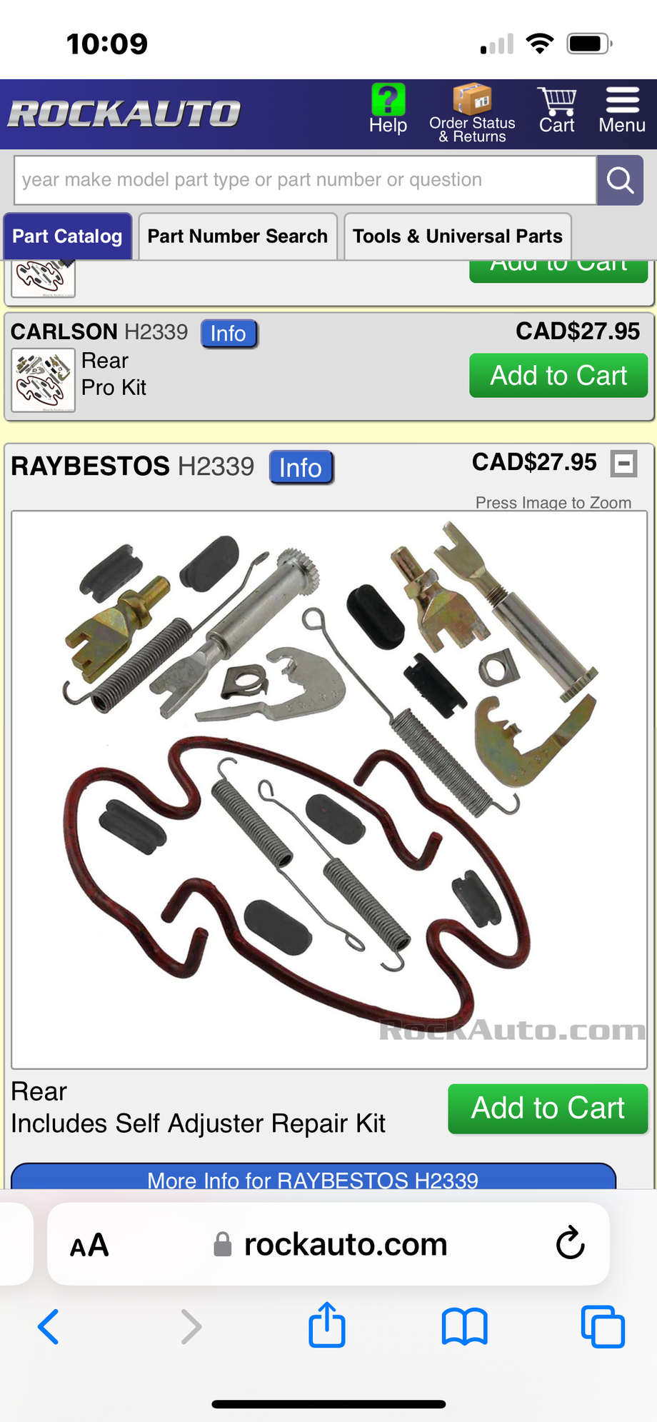

So I adjusted the star screws and that seems to have fixed the pedal travel! I adjusted the rear right screw 20 clicks and the rear left screw 15 clicks. With the parking brake at 3 clicks, the car will not move in drive on a flat surface.
The spring kit i provided was installed correctly and all the bits were still new. While his one hired worker, aside from his son, isnt the brightest tool in the shed, the shop does good work.
