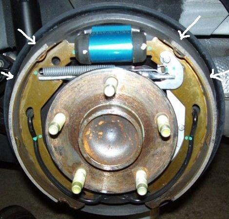

The rear Brake shoes have 4 important contact points on the backing plate.
(see arrows in pic) This is where the backing plates get a thin layer of hi-temp grease to prevent squeaks.
And again NEVER Blow the brake dust off..
You can use a spray bottle with water to clean things if you have no Brake-Kleen..
