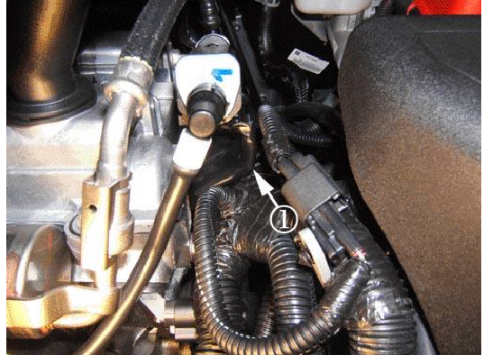

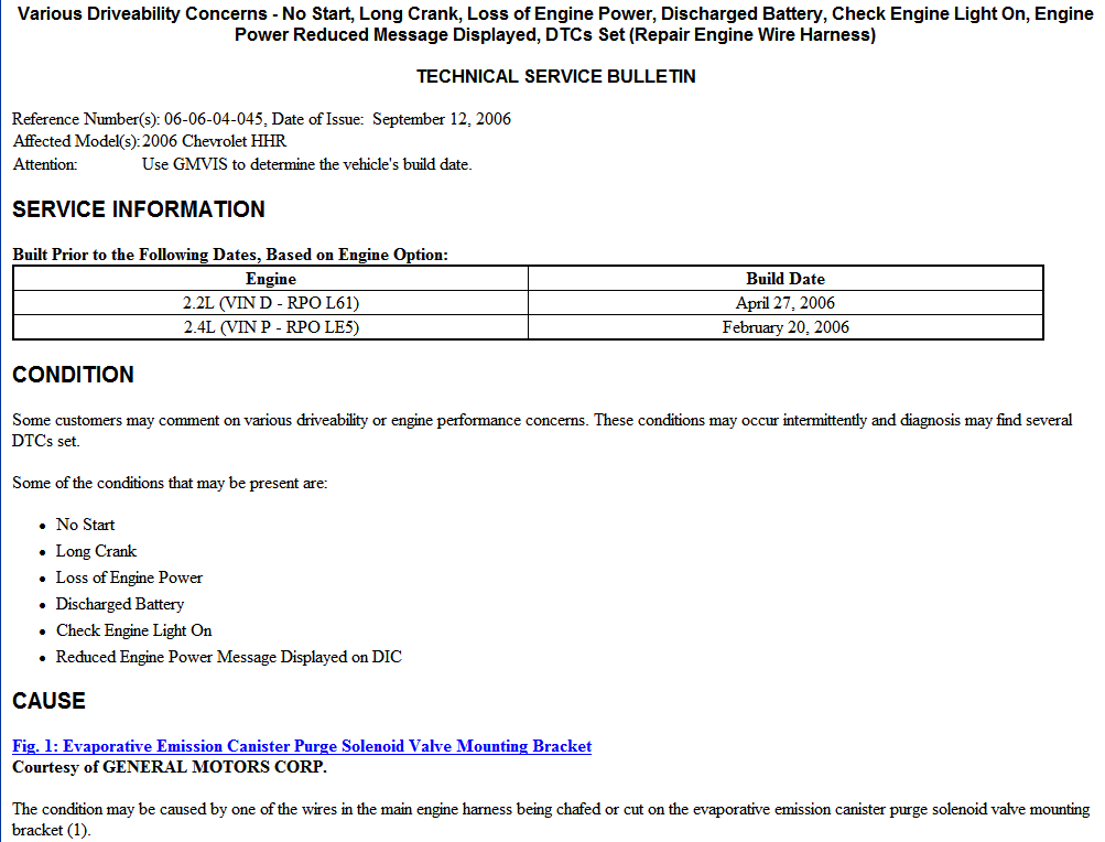

There are TSBs about fretted wires 09-06-03-004D, 08-06-03-009A and (important one) 06-06-04-045. You should be able to find those by typing the number into GoOgle, if you have no luck PM me. That third one applies to 2.2L cars built before April 27, 2006 and is a real good candidate, since you almost had to jiggle that wire.

The main thing the TSBs all say is "don't replace the ECM" if it's not reproducible and intermittent. They are mostly about wires and contacts.
