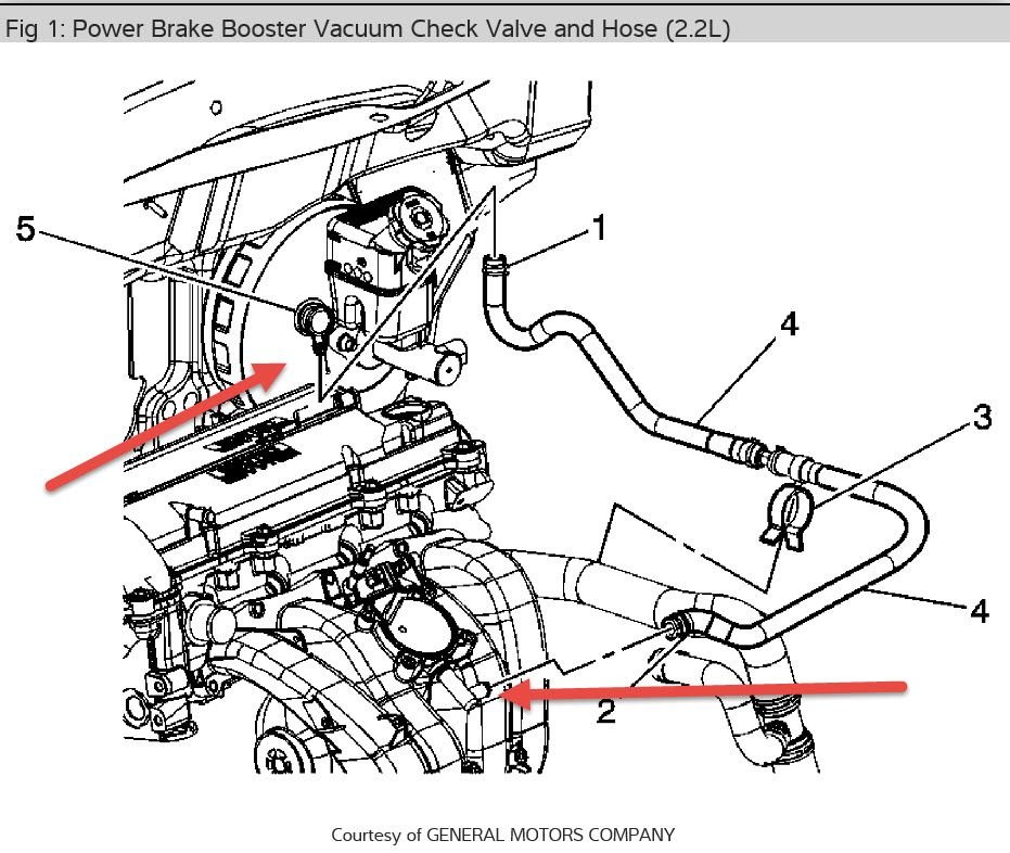

If that’s a possibility, then so should the MAP sensor, first off check the plastic pipe that runs from the under hood EVAP valve to the intake manifold near the MAP sensor any nicks in the o ring? Is the fitting connected tightly, possibly spread a little silicone grease on it to ensure a good seal and while your there same for the MAF sensor lube the o ring to ensure a hood seal.
Same for the brake booster hose , it connects to the intake manifold at point #2 , marked by a red arrow
The check valve is #5 also look for the red arrow
For the price order a new check valve
Don’t forget the discount code!!
