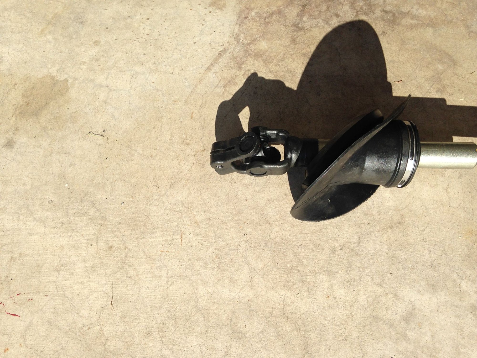

Yep, Oldblue, chiming in, your gonna need a 13 mm wrench, a small hammer for the interior yoke up under the dash, you have to pull up the rubber boot, . Remove the pinch bolt in the bottom yoke , I used an air chisel to rattle the yoke up and off the rack.
Now the rack end is shaped so it only goes on one way , the column end you need to mark carefully at the split in the yoke, then it’s gonna line back up nicely. Now don’t move the front wheels or the steering wheel or as mentioned that clock spring is a problem.
This was the wrong part, notice the length of the yoke
The OEM yoke, that’s the lower pinch bolt
