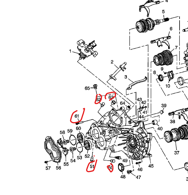

Also, do I need to drop the transmission (again) to reseat whatever is supposed to be in the other end of the bolt, or would continuing to tighten it down do that? Originally it was really torqued down.

My guess on the detente bolts is torque them down unless there is a lock nut on them.

I still don't think it's the no 51 item in the diagram above. His picture shows it is adjacent to the bell housing, which places it on the bottom of the engine. The bolt he is referring to is the long oil pan bolt.
